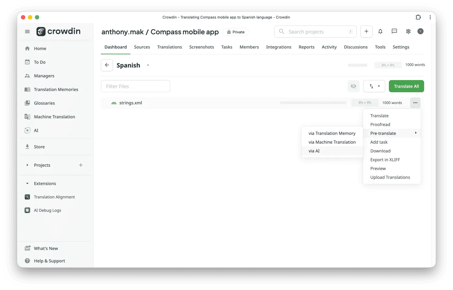

AI translation cost in Crowdin
We used the standard Crowdin AI prompt for pre-translation without human review or custom glossary/translation memory injection.

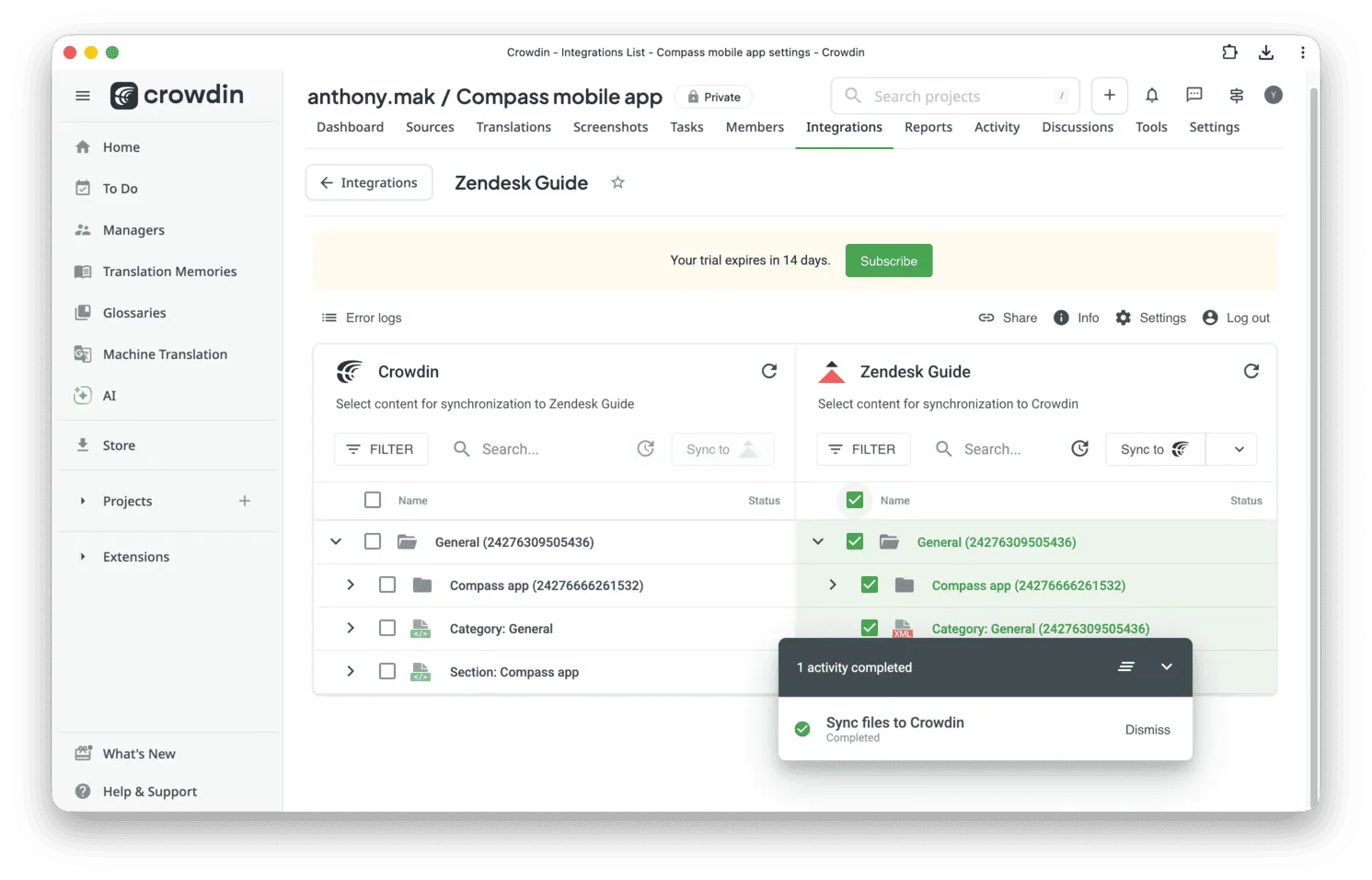

We uploaded a 1k-word article to the Zendesk knowledge base. Using the Zendesk x Crowdin integration, we synced the article to Crowdin, used AI pre-translate, and recorded all the received numbers.
Cost of translating Zendesk article via Crowdin AI

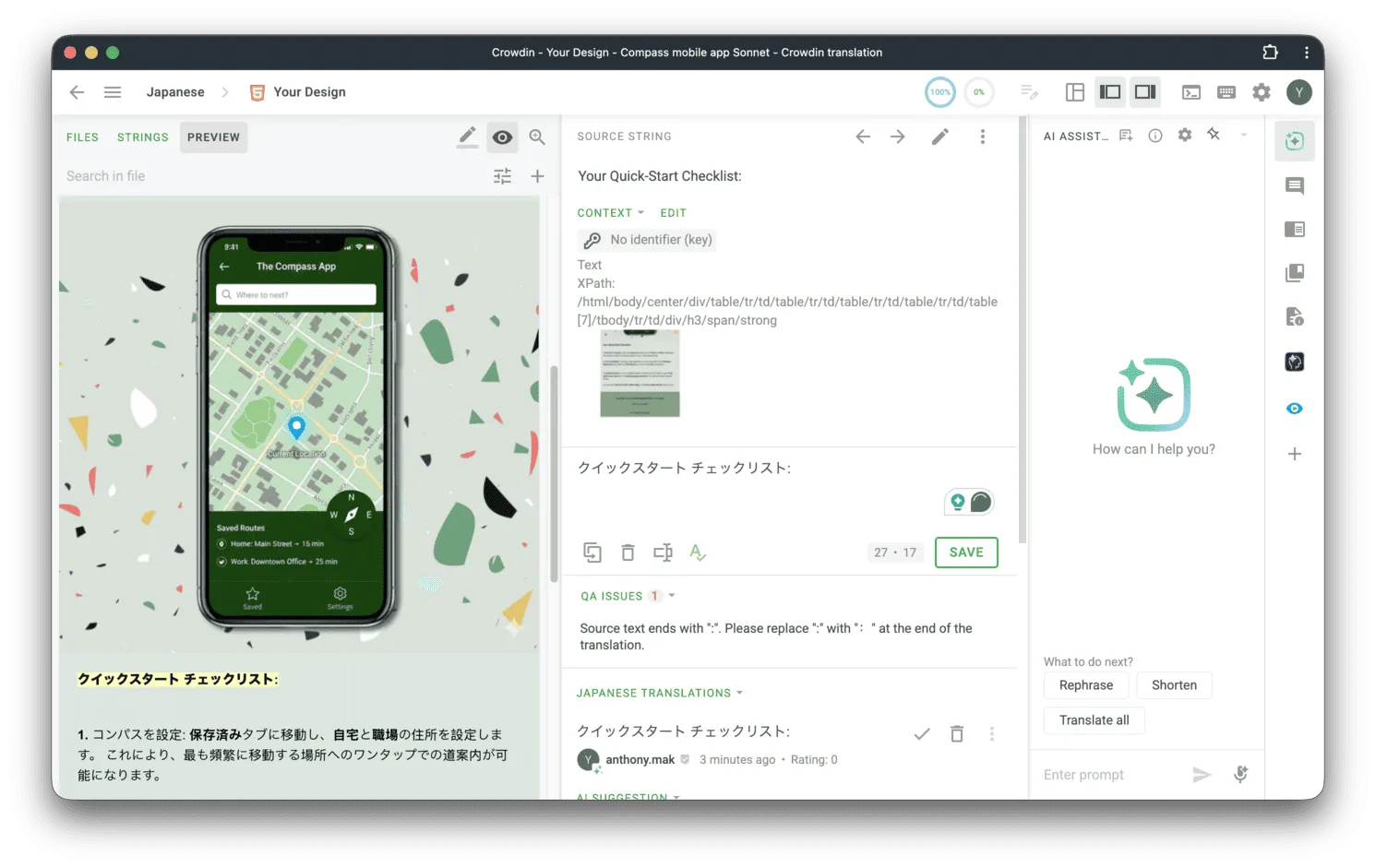

3. Cost of Marketing Email AI Translation with Visual Context
Marketing localization requires an understanding of layout and design, which is a part of a broader business translation strategy. To test this, we synced a “Thank you” email from SendGrid to Crowdin.
The email includes a preview in the editor, which can be useful for linguists during proofreading and transcreation.
This time, for context-aware translation, we decided to provide AI with 2 screenshots and used the auto-tagging feature in Crowdin. AI utilizes “multimodal” capabilities (vision), which impacts the final cost. Because of the context, we used GPT 5.1 in this experiment.
By providing visual context, you reduce the risk of translation errors when AI works blind.
